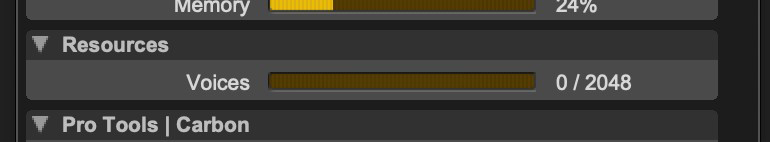

When we state the limit in Pro Tools | Ultimate we refer to a voice limit. Prior to Pro Tools 2021.6 the limit was either 256 voices per card for HDX systems (a maximum of 768 for a three-card system) or 384 voices when using a Native audio engine—HD native, Core Audio, or ASIO. How those voices are used depends on the session. You could use 256 voices by creating 256 mono tracks or use up the same number of voices by creating 32 7.1 tracks. Another point to bear in mind is these voice counts are halved when you double the sample rate.

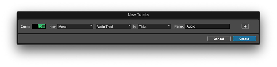

So how does Pro Tools 2021.6 change this? The first thing is to say that if you are using HDX Classic—i.e., the Hybrid Engine is turned off—then the voice limitations are the same: 256 voices per card, because the voicing is handled by the hardware. However, if you are using the new HDX Hybrid Engine or any other native playback engine—HD Native, Core Audio, or ASIO—then the voice count goes up to a massive 2048 voices, more than twice the number that you would have with a three-card HDX system! Not only that, you get 2048 voices at all sample rates. This gives you the potential to build huge Pro Tools sessions.
new tracks window in Pro Tools
voices count in Pro Tools

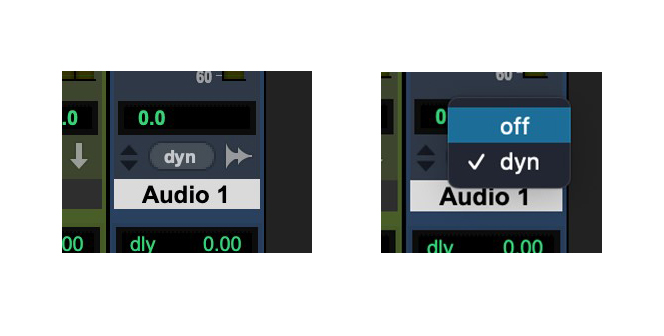

The Pro Tools | Ultimate Audio Track limit is also raised to 2048. Pro Tools | Ultimate allows you to create more tracks than can be voiced. For example, you could create 256 7.1 Audio Tracks, which will use up your 2048 voices but not your Audio Track count. However, it’s possible to switch a track’s voicing from Dyn to Off in order free up voices, giving you lots of flexibility.
switch off track voicing in Pro Tools

How do things change with the release of Pro Tools 2021.6? The good news here is that the Audio Track count doubles from 128 to 256 Audio Tracks. The even better news is that doubling the sample rate no longer halves the available Audio Tracks. If you are someone who likes to work at 96kHz then you will now have four times as many Audio Tracks at your disposal than you had previously!
new tracks window in Pro Tools with 256 tracks
