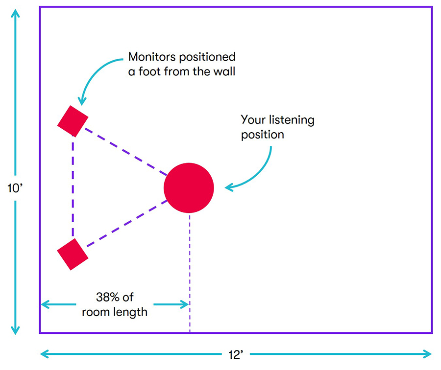

Your monitors should fire down the length of the room. For example, if you're in a room measuring 12 feet long and 10 feet wide, position your monitors firing down the 12-foot length of the room. The best listening position is around 38 percent of the room's length from the wall you'll face while listening. This is where the bass response will be the flattest. The rear side of your monitors should sit at least a foot away from any walls, or the bass response will be exaggerated. Center your listening position between the side walls.
Your monitors should be an equal distance from both your listening position and each other, creating an invisible equilateral triangle. Angle the monitors toward your position at around 30 degrees, and align the tweeters to around ear level. Adjustable height stands make it easy to position your monitors and, as a bonus, will isolate them so you won't hear any resonance from the floor. You can put monitors on your desktop, but they should sit on decoupling pads or small stands to isolate them from the desk's surface.
diagram showing listening position relative to monitors and room size in a home music studio
Position your monitors so they fire down the length of the room and place your listening position so you form an equilateral triangle with the monitors. This diagram shows a hypothetical 10 by 12 foot room.
Most monitors are meant to stand upright, so avoid laying them down sideways unless they're specifically designed to be used horizontally. Laying them flat can result in comb filtering, and this potential phase cancellation may affect the sound and smear the stereo image. Monitors designed to work on their side have drivers located in precise positions to counter this. Keep all others standing.
