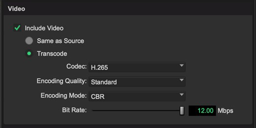

H.265 (HEVC)
Pro Tools | Ultimate can now import, play, and export H.265 video. H.265 has benefits in overall codec efficiency and adds compatibility with devices that use these formats, such as iPhone, allowing those files to be directly imported into Pro Tools. Exporting may be done with variable or constant bit-rate settings just like H.264. There is an additional Encoding Quality control that offers a balance between quality and bit-rate precision versus encode speed.
