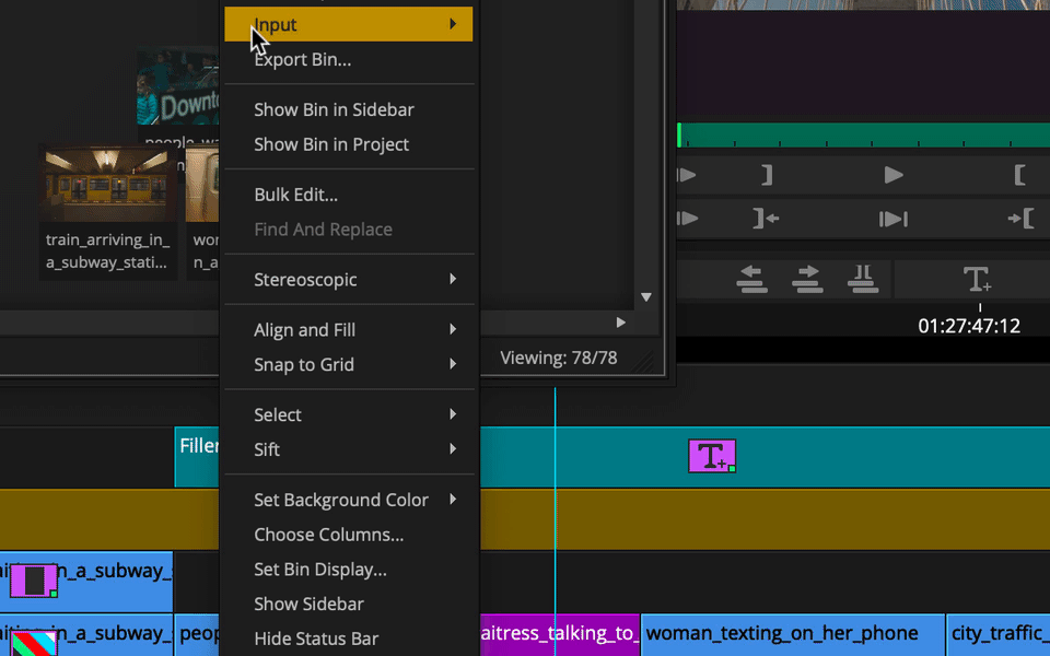

Bin “Snap to Grid”
Expanding on the existing bin features to align and display your media in frame view, you can also enable a grid system to easily organize and view your content the way you want.
When you access the “Snap to Grid” function from the fast menu in the bin or the bin menu, you are presented with options to enable the grid. You can set it to be on display the entire time in the current bin, make the grid “active” but visually invisible, or set it as “temporary.” This gives you the best of both worlds—as you move your clips, they are initially freeform to where they can be placed, but if you hold for a beat, the grid will display, and you can align to the active grid.

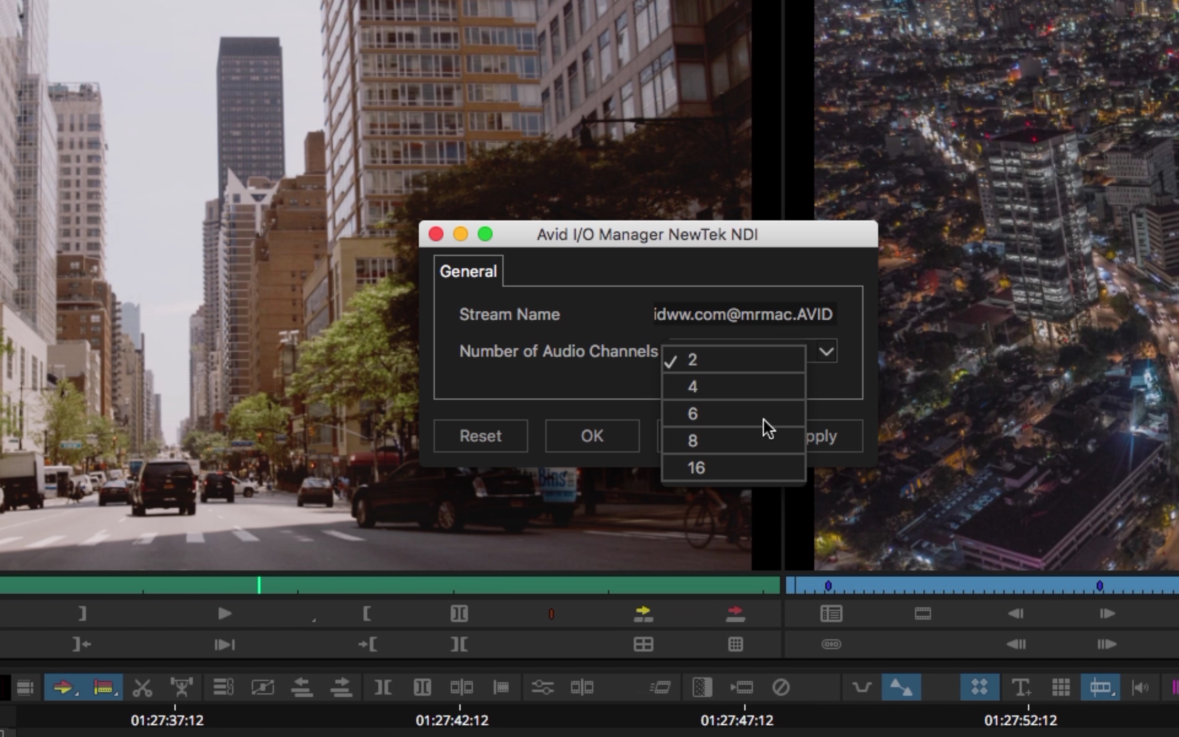

NDI Control Panel
Users of the popular NDI technology from within Media Composer now have the added ability to choose how many tracks of audio to play: 2, 4, 6, 8, or 16. This is configured through the new NDI Control Panel exposed from the timeline’s Hardware/Software switch.

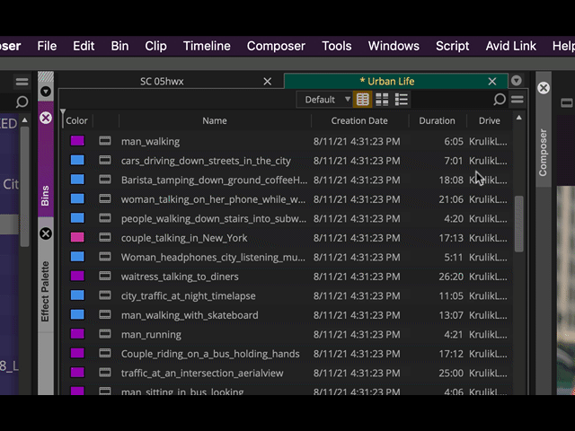

Bin Column Width Adjustments
Bins can contain and display a substantial amount of alphanumeric text and metadata. Depending on the size of the font or length of information, sometimes it can’t all be displayed due to the size of the columns in the bin’s text view.
With the latest release, you can easily adjust the size of your bin columns to a width of your choice by simply clicking and dragging the column separator. Double-clicking the separator between columns will automatically resize the entire column for you.

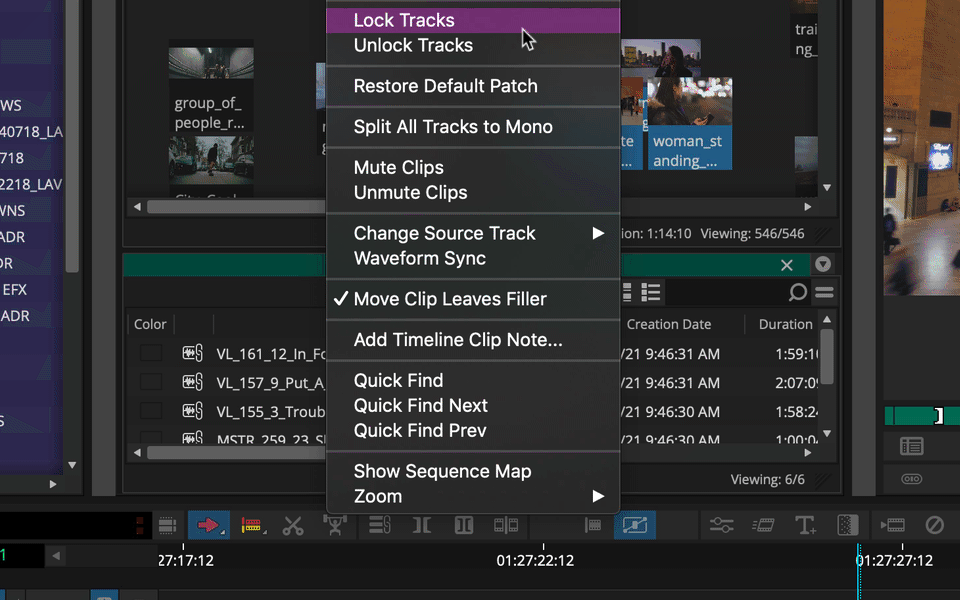

Move Clip Leaves Filler
You can move clips in your timeline by dragging them directly in the timeline or using a keystroke to move them up or down and left or right. But if your segment mode is set to “overwrite,” you could potentially wipe out an edit as you move across it. This may not be your desired result.
The “Move Clip Leaves Filler” function in the timeline lets you choose how you want your edits to behave as you move clips within your timeline. Do you want it to wipe out the underlying clip by leaving filler in its path? Or do you want to keep the clips where they are currently edited? The choice is yours.

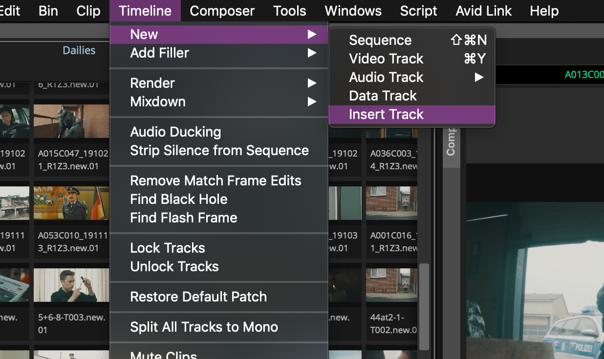

Insert Tracks
Over the years, editors have found different ways to do the same things in Media Composer. It could be moving groups of clips in the timeline with the mouse or a keystroke. And sometimes there may be a special keystroke to perform a function. One of these hidden keystrokes to insert a track, without having to select edits and move them is now part of the Timeline pulldown menu. Insert any new audio or video track and the edits currently in your timeline will adjust with ease to their new location.
