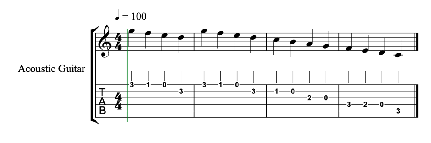

To help you navigate your score and play back more easily, we’ve added a number of improvements to ‘Go to Page’, ‘Go to Bar’ as well as introduce a new Replay Line. Both ‘Go to Page’ and ‘Go to Bar’ functions, found in Home > Edit > Go To, now move the playback line to the start of the page or bar you go to. This saves several steps afterwards to play back the score from that point. Simply use the shortcuts Cmd+Alt+G/Ctrl+Alt+G to Go to Bar, and Cmd+Shift+G/Ctrl+Shift+G to Go to Page and press Space to start playback.
We’ve added a new Replay Line that shows the location in the score you can replay the music from (when using Ctrl+Space on Win or Alt+Space on Mac). This appears as a dashed green line and can be turned on from View > Invisibles > Replay Line:
In addition to this, we’ve made a small change to turn OFF the preference to Use different zoom during play and Flexi-time by default (it should stay on if you already have this set). This preference has its uses, but is better suited for new users in its new default state. To toggle this, go to File > Preferences > Score Position.
Half Speed playback
In this release, we’re introducing the ability to play the score back at half-speed. You can find this in the Play button’s dropdown:
Play at Half-Speed triggers playback from the position of the playback line at, you guessed it, half the tempo. This will be particularly useful for composing, arranging and teaching with Sibelius.

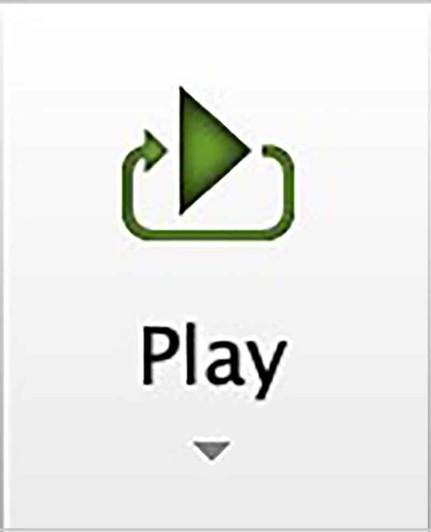

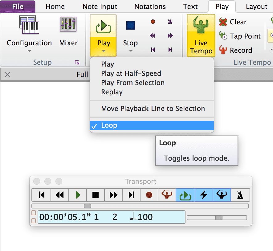

Loop
New icons in the Ribbon and Transport windows, which has been lengthened to accommodate the new button
To engage Loop mode, select the passage in the score you’d like to play back, and go to Play > Transport > Play > Loop. During playback, you’ll see the Playback line in the score and the Timeline will loop around as the music does too. As you would expect, it’ll continue to loop ad infinitum until you press stop.
The way it works is pretty simple and fits right into the same playback workflows we already have in Sibelius:
  • Make a selection and press P to play – Sibelius will play from the beginning of the selection and loop when it gets to the end of the selection
  • Press Spacebar, and Sibelius will start playback from where the playback line is in the score. If it’s before the selection, it’ll play back and pick up the loop on the way through. If it’s after the selection, playback will start as normal and not loop (since it never gets to the loop selection)
  • The selected staves are respected too, so you only hear the instruments that are selected.
Loops even pick up playing articulation changes that occur mid-selection, allowing your Trumpet, say, to start off with a mute and then switch to open a few bars later. When Sibelius loops back, the mute is restored.
We’ve added special logic for loops that contain repeats:
  • Selection contains no repeats: simply loop from beginning to end
  • Selection contains a complete repeat (including multiple endings): fully respect the repeat structure, and loop the whole selection, including repeats
  • Selection contains the end of a repeat, but not the beginning, and selection continues past the end repeat sign, then play the second iteration of the repeat (i.e. the one that transitions onward after the repeat)
  • Selection contains the end of a repeat, but not the beginning, and the selection does not continue past the end repeat, then play the first iteration of the repeat (as this most closely resembles the visual selection)
There are some edge cases that we’ve had to make decisions on as well. For example, if you have part of a 1st-time repeat structure and the 2nd-time bar selected, Sibelius will only play the notes in the selected 2nd-time bars.

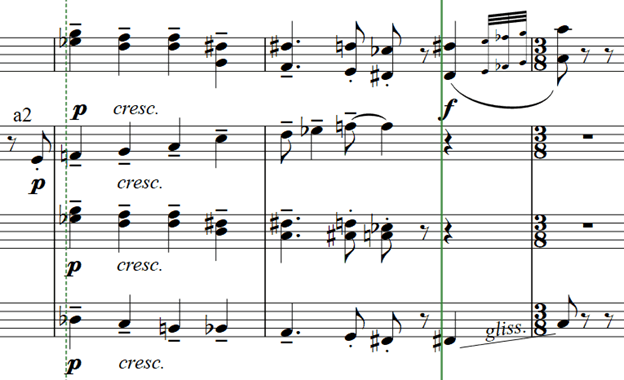

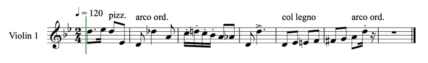

Introducing Scrub, a new way to audition notes and chords in your score. This feature is available via the square brackets [ and ] keyboard shortcuts, and you’ll hear Sibelius briefly play back the notes under the playback line.
Using Y (as before) you can move the playback line to any place in the score, or using the Go to Bar and Go to Page operations (from 2019.1 move the playback line as well of course). You can then use [ and ] to hear the notes being played as the playback line moves past them.
When you Scrub, Sibelius will play the notes for the duration that they are written. It will continue to move to the next note as you press the square brackets, and will skip rests and whole empty passages. As with Loop, scrubbing takes the passage selection into account as well, so you can scrub over only some of the instruments as needed, useful for auditioning just those you’re working on.
We’ve made sure new playing articulations are picked up as well. In previous versions, Sibelius would only reassign sounds when you triggered playback. This was evident in the Mixer showing unallocated on every instrument fader. Now though, you can scrub over a note, add a playing articulation that may trigger a change in patch (e.g. mute, staccato etc.) and Sibelius will pick it up when you scrub. When scrubbing, the playback velocities are ignored, allowing you to hear a clear interpretation of the notes being played. All playing articulations and techniques are taken into account as well, of course.
When moving from one note or chord to another, Sibelius will cancel the sounding notes as you scrub to the next or previous note. It does this so you don’t end up with a mush of sound, however Sibelius takes ties into account too, so you get a true impression of what’s in the score.
Since we’re re-purposing the Fast-forward and Rewind shortcuts, you’ll need to manually reassign these if you use a custom set of keyboard shortcuts in Sibelius. The new Scrub Forwards and Scrub Backwards commands are found in the Play tab section of the Keyboard Shortcuts preferences. To Fast Forward and Rewind as before, the shortcuts are now Alt+] and Alt+[.

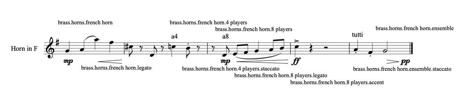

Playback support for a2, a4, an converts into n players
Up until now, adding “a” numbers to a score, to denote the number of players needed for a passage of music, wouldn’t do anything in any sound library since Sibelius didn’t have a way to convert these to numbers of players. NotePerformer, as you may know, comes with a plugin to interpret these instructions on the fly, but the plugin would have to be re-run if the user changed their mind. The Sibelius 7 Sounds sound set also includes 4 players for the Violins, 3 players for the Violas, Celli and Basses.
In 2019.4, Sibelius can interpret the number of players needed by reading “a2”, “a4, “a8” etc. into “+n players” soundID changes that any sound library, including NotePerformer and Sibelius Sounds, can interpret into changes in sound. For example, writing “a1” or “a 1” (with a space) or “à 1” into a score, will change the sound playing back to a solo instrument. In the same way, writing “a 8” will change the sound so you hear 8 players, and so on. Of course, the limitations will be in the sound library, so don’t expect this to work with everything. Also, at the time of writing, Arne Wallander hasn’t implemented this in NotePerformer, but do be on the look out for an update in due course.
For those interested, you can see how this works in the Playback Dictionary. Scroll down to the bottom and you’ll see this:
^[aAàÀ][ ]?([0-9]+)
Those familiar with regular expressions will know exactly what this means, but those who aren’t, it essentially allows Sibelius to interpret any piece of staff text that starts with a, A, à or À that could have a space after it and then any number after that. It then triggers a sound ID change of +$1 players, where it takes the number entered in the staff text and forms the sound ID change to trigger the right number of players. Another change we’ve made is to reorder the sound IDs so the numbers of players have the same priority as .ensemble.
All in all, this has allowed us to support the following, which shows the sound ID changes that Sibelius goes through when playing this example. As always, these changes in sound will only be audible if your sound library supports them. If not, it’ll fall back on the best next sound.

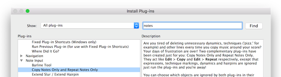

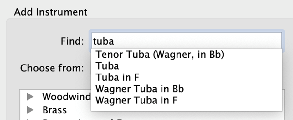

Searching for instruments and plugins
Ever wanted to add a cello to your score but couldn’t find it immediately, remembering you had to search for Violoncello? Ever wanted to find a new plugin but didn’t have the time to wade through the hundreds of available plugins?
The wait is over! You can now you can search for instruments in the Add or Remove Instruments, and Instrument Change dialogs with ease. Simply type part of the instrument’s name, and all those matching will appear underneath it. Good examples to try are Guitar, Tuba, Trombone and so on.
The Install Plug-ins window now has its very own search bar too. It searches for exact matches only though, so “Copy notes” works, but “Notes copy” does not, however simply searching for “notes” will cycle through all plugins with the word “notes” in the title.

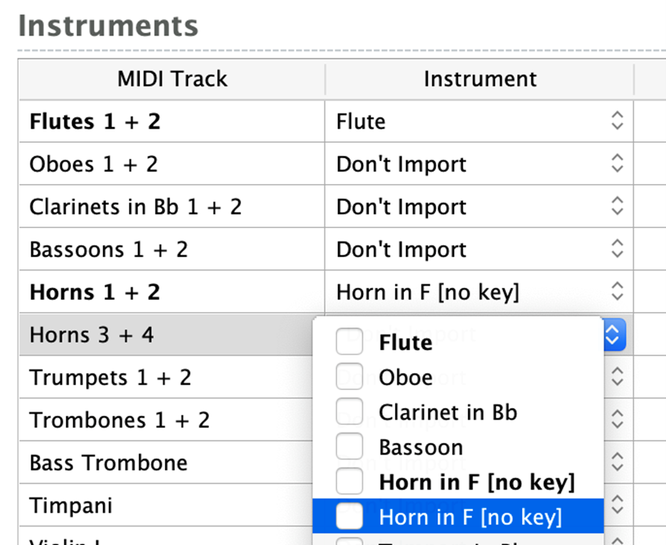

Instruments table
This is where you assign the incoming track to the destination stave in the score. When opening a new MIDI file, you’ll see the MIDI track names on the left, with three columns to the right for assigning the Instrument and adding Articulations and Techniques. The Instruments list will be set to “Don’t import” by default, ready for you to assign the MIDI tracks to the instruments that are in the score. Using this method, it’s now possible to import only some of the MIDI tracks as you need them, useful for getting a revised set of String parts for a partially completed score, for example.
To assign a MIDI track to an instrument, click the arrows within the Instrument column and choose an instrument. As you go through this, you’ll notice both the MIDI track name and Instrument name go Bold, so you can see which ones you’ve done – really useful for larger scores.
The assignments can be made in several ways:
• 1-to-1 mapping: An incoming MIDI track is mapped directly to a single instrument in the score. This is the most basic type of import.
• 1-to-many mapping: You can map a single MIDI track across several instruments. This is really useful if you have a MIDI track that contains the whole strings section, say. You can map these to several instruments in the score (there’s no limit) and Sibelius will spread the notes across the staves evenly based on the range of the instrument. Under the hood, it utilizes an updated version of the Arrange feature to spread the notes across the staves. Another good use for this is to spread a single Guitar track across both notation and tab staves. There’s an option at the bottom of the Import page that will toggle between copying the music to all staves, or to explode them. It’s called “Explode music when arranging to multiple instruments”.

When importing the MIDI file, you can assign the incoming Acoustic Guitar MIDI track to both the notation and tab staves:
This then copies the guitar across both the notation and tab staves:

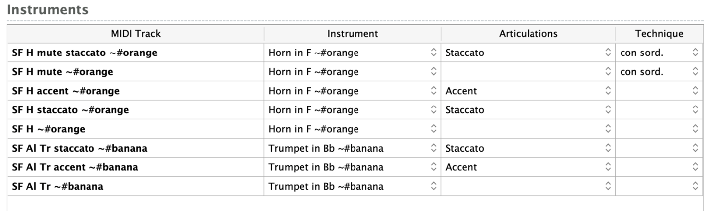

This score simply has a French Horn and a Trumpet. In Pro Tools, the MIDI Tracks were named by the composer to remind them which sample had been loaded. This is common, so in this case there’s SF H (for Spitfire Horns) and SF Al Tr (for the Spitfire Albion Trumpet). Each track also has the playing articulation or technique in the name, as well as a hashtag.
Then, in the score, the same hastags have been added to the instrument names. Since they are proceeded by a tilde ~ character, the text is not shown in the score.
This example shows just two instruments, but you can easily see this scales up to any score at any size. All this combined can enable a full orchestral score to be imported into Sibelius with a single click:
