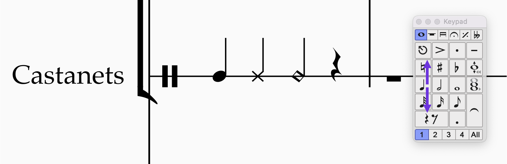

When dragging notes into a percussion stave from the keypad, Sibelius will now cycle through the available noteheads that are defined in the drum stave. As you drag up, the grey ghost note will cycle through the available noteheads, including the playing articulations that are defined on that stave. For 5-line staves, there can be many noteheads to cycle through, but for a 1-line stave with only a few defined, you can quickly enter notes confidently that will play back and ultimately be clear for the percussionist to play.
Simply release the mouse-drag and the note will go in. Using this method, you can’t go beyond the limits of the drum stave or enter something that will be unintelligible for the percussionist.

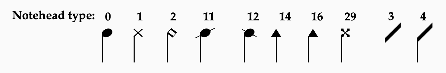

Sometimes you need more freedom to enter noteheads that aren’t defined on the stave. To do this, hold down the Alt key while dragging. The vertical drag will continue to control the pitch, and dragging left and right will cycle through these common noteheads:
Sib 202112 3
However, this isn’t the complete list of noteheads in Sibelius, so you can always choose the one you need from the Notations > Noteheads > Type list (on desktop), or by using the Shift + and Shift - shortcuts to cycle through the whole list.

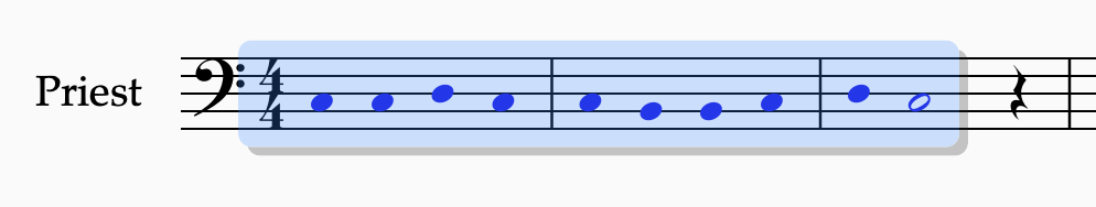

Then, select the notes or rests you need to be transformed into a single bar:
Sib 202112 5

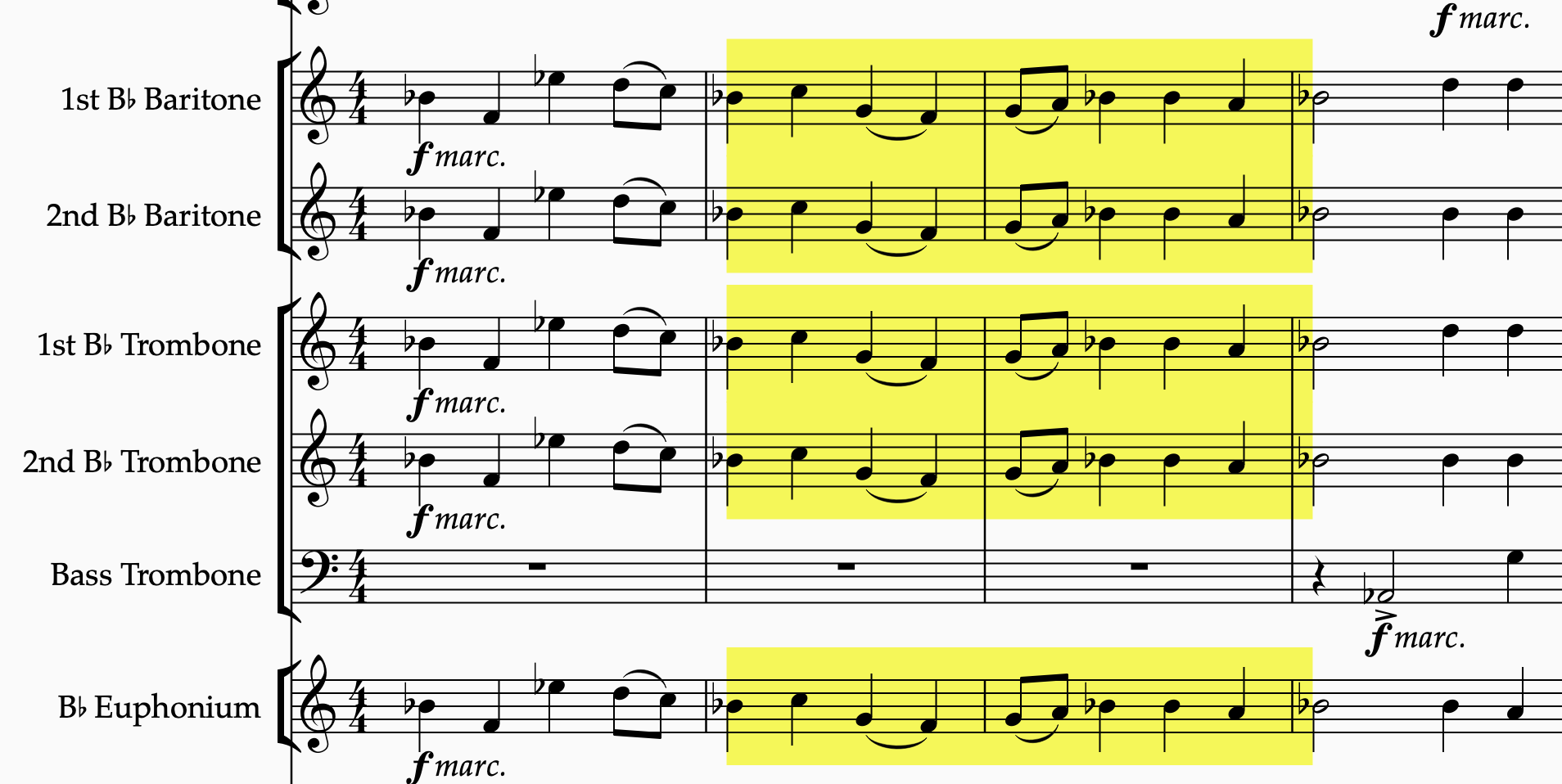

Highlights have had a boost in this version, allowing you to apply them across several instruments at once.
Sib 202112 9
The passage selection can span several bars across different instruments or the whole score. Simply select the passage you’d like to highlight and go to Review > Highlight.

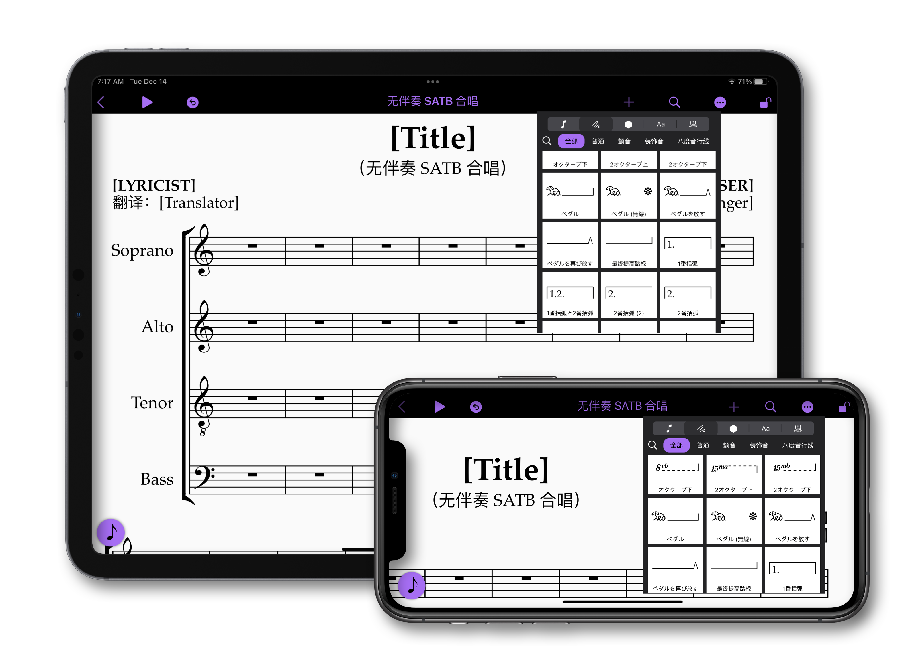

Chinese Support (Mobile Only)
We’ve had a huge number of requests to translate Sibelius for mobile into Chinese, so we’re pleased to introduce this in our most recent release.
Sib 202112 10
