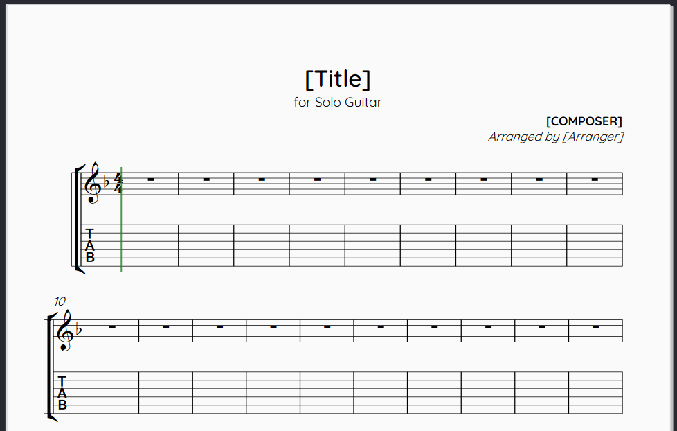

The easiest way to get started is to open the “Solo Guitar” manuscript paper from the Quick Start:
1 New score
You can then start entering notes into either the notation or tab staff and the music will be entered into both staves.

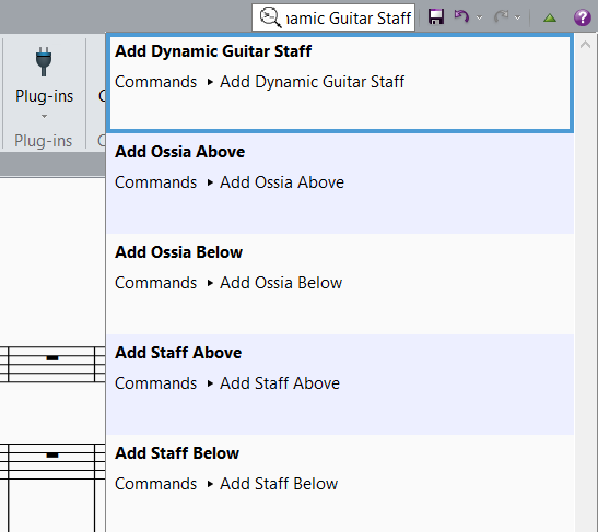

Adding to an existing guitar in your score (mobile and desktop): As you probably know by now, every feature is just a few keystrokes away in the Command Search in the top right corner of the window. To add a new dynamic guitar, select your existing guitar staff and type “Add Dynamic Guitar Staff” in the Command Search field in the top right corner:
5 Add DGS Command Search
Sibelius will either add a new notation or a new tab staff in your score, depending on which one you had selected, and will automatically populate the music from the original staff to the new.

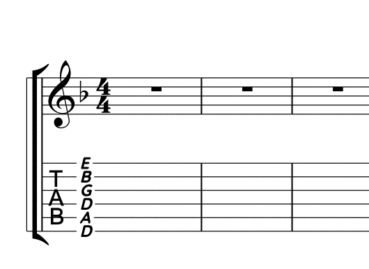

By default, Sibelius will use the standard EADGBE tuning when creating a tab staff, however it’s common to use different tunings when writing for guitar. To change the tuning of the tab staff in Sibelius, add your tab staff to your score, as above, then add an Instrument Change by going to Home > Instruments > Change. Choose the tuning you need, for example “Acoustic Guitar, dropped D tuning [tab]” or “Acoustic Guitar, DADGAD tuning [tab]”, click OK and then click just before the start of the first bar of the tab staff. This will change the instrument throughout the score from the start and update the tablature across the whole staff to use the new tunings.
Don’t forget to update the notation staff to use the new tuning for your guitar chord diagrams too. To do this, select your notation staff and go to Home > Instruments > Edit Instruments and click Edit Instrument. In the bottom right of the Edit Instrument dialog, in the Chord Symbols section, set the “Tab instrument to use for string tunings” to be the same tuning you’ve set your tab staff to be. This will ensure the chord symbols you add to your staves will match the tuning of your tab staff.

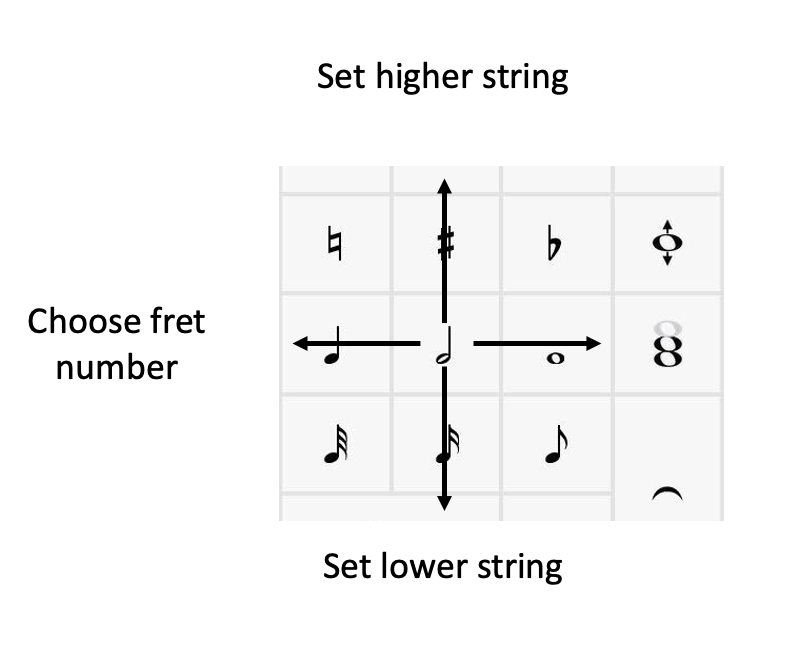

7 Tab input gestures
Using pencil gestures, you can lean into the pencil to enter note input mode, then again and up to set the fret number, and left to right to set the note duration.
It’s a quick and fun way to enter notes quickly into your score in both notation and tab staves.

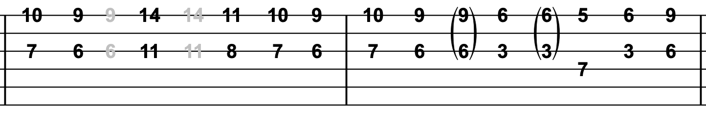

Now there are two options for tied notes. By default, the tied-to note will be hidden. But if you want this second note bracketed, simply add the bracket and it’ll un-hide the note:
11 New tie options
If you need a combination of bracketed and unbracketed notes, we recommend you revert to non-dynamic guitar staves until we make further improvements in this area.
