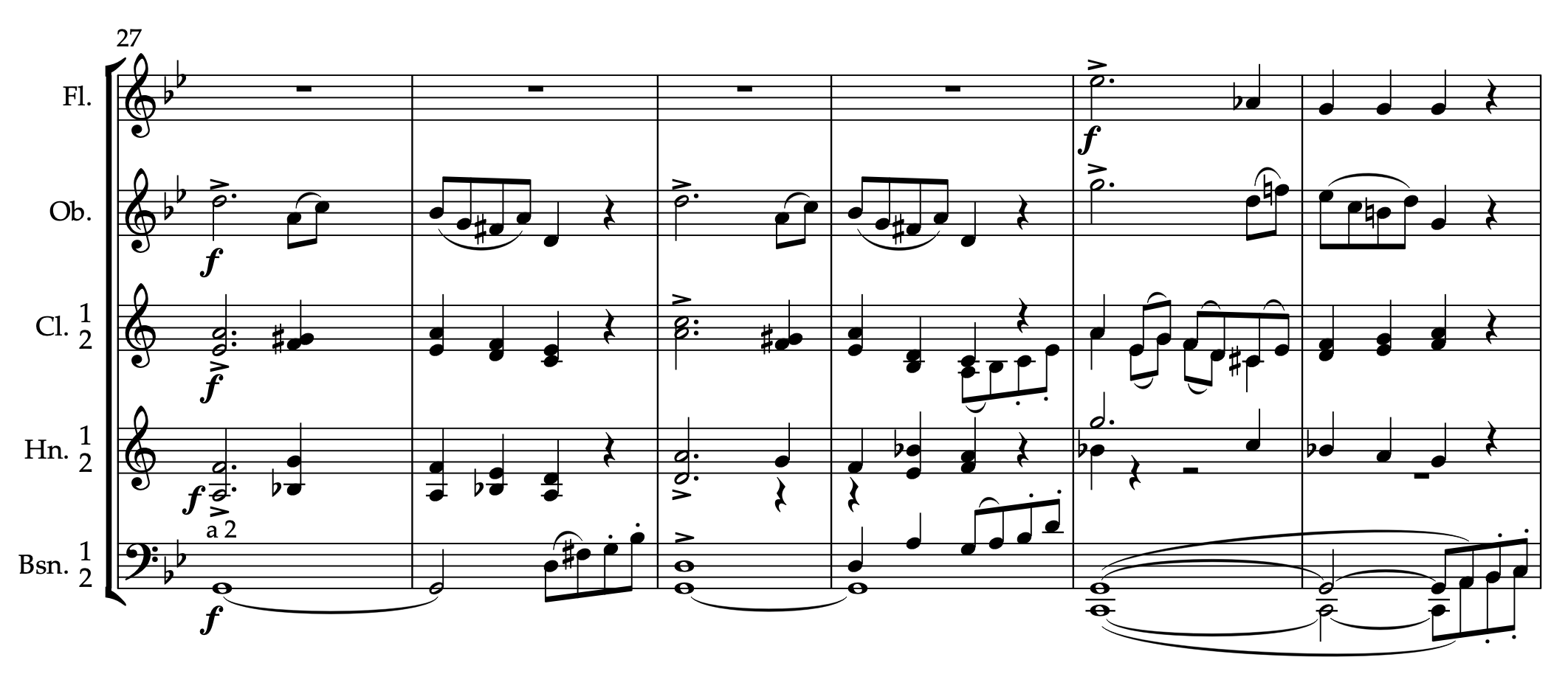

The limits we’ve had in Dynamic Parts have been related to creating a part for each player from a combined staff in the score. It’s common in the full score to use combined staves for the players in a section; on a practical level, it’s useful to save vertical space on the conductor’s score and to aid score reading efficiency.
1 Full score
However, it’s also very common to need individual parts for each player. The image above shows parts for the clarinet, horn, and bassoon players sharing one staff each.
To create two independent parts in previous versions of Sibelius, where the individual notes from the chords and passages in multiple voices are split out for each player’s part, it would have required you to extract the part from the score entirely and work on it in two separate files. You would then have to constantly check between the original full score and each part to make sure any changes are covered in each file. Multiply this for each player, and you suddenly have many individual scores to keep track of.
Now, in Sibelius 2023.5, you have the ability to split the original staff into two Dynamic Parts, enabling you to achieve the following for the first time:
2 Full score 2 horn players
Full score on the left with a combined horn part, and with individual horn parts on the right

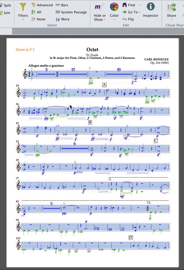

Each player’s part is achieved in just a few simple steps using existing features you’re likely familiar with already.
3 Creating Horn 1 part
Here’s a quick tutorial on how to create the individual horn part, with an animation for illustration:
  1. Select the bars you need (this can be the whole part or just a passage).
  2. Select Home > Select > Filters and choose Player 2 (since that’s the player you want to hide from this part).
  3. Finally, select Home > Edit > Hide or Show—or use the Command+Shift+H (Mac) or Control+Shift+H (Windows) shortcut as I did above—to hide it.
Sibelius then hides the second player from this part, creating a Horn 1 part in seconds. The process that Sibelius does here is nothing short of miraculous, and as this is in a Dynamic Part, the full score and other parts are unaffected by the process. You can safely go off and create subsequent parts in the same way.

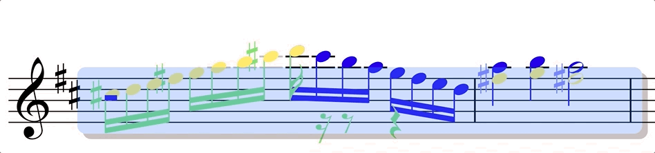

To enable all of this, Sibelius is now able to hide individual notes in chords. Previously, if you tried to hide a note in a chord, the whole chord would be hidden. However, hiding a note is fairly easy for Sibelius to handle, but the real smarts come into play when adjusting the music around the hidden object.
You’ll see from the above animation that not only are the Voice 2 notes and bottom notes in chords hidden, but the rests, lines, text, and even bar rests reposition as though the music for Player 2 simply isn’t there.
Here’s a list of things Sibelius now readjusts automatically for you:
  • Stem direction—for passages of music where the players are divided between chords and/or voices, Sibelius will redraw the stems based on the context around them
  • Ties and other lines are redrawn around notes—this works with tie-into ties and L.V.s as well
  • Bracketed noteheads will cover only those notes it needs to
  • Beam angles will be redrawn and stems flipped as needed
  • Arpeggios and tremolos will adjust their length and position
  • Articulations will move to be above or below the remaining shown notes
  • Rhythm dots will move to the appropriate spaces on the staff
  • Accidentals will update the notes further down the bar when notes are hidden
  • If bars now appear completely empty, a bar rest will be inserted; if it’s next to other empty bars, they will form a multirest

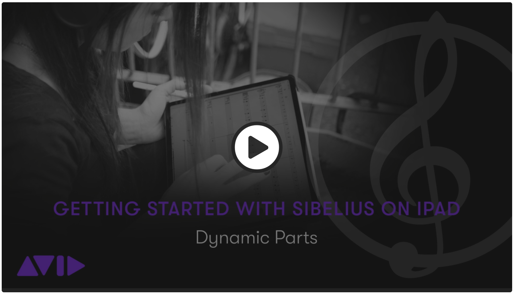

In Sibelius, you can create new parts in a number of ways; in fact, Sibelius automatically creates parts for you in new scores. On both mobile and desktop, you can select the instrument(s) you’d like in a new part and then launch “Make Into Part” from Command Search.
This creates a new part and brings it into view. You can then change the name of that part for the player you need by editing the instrument name in the top left:
4 Edit part name
To navigate through parts in the mobile app, see this handy video:
5 Parts video

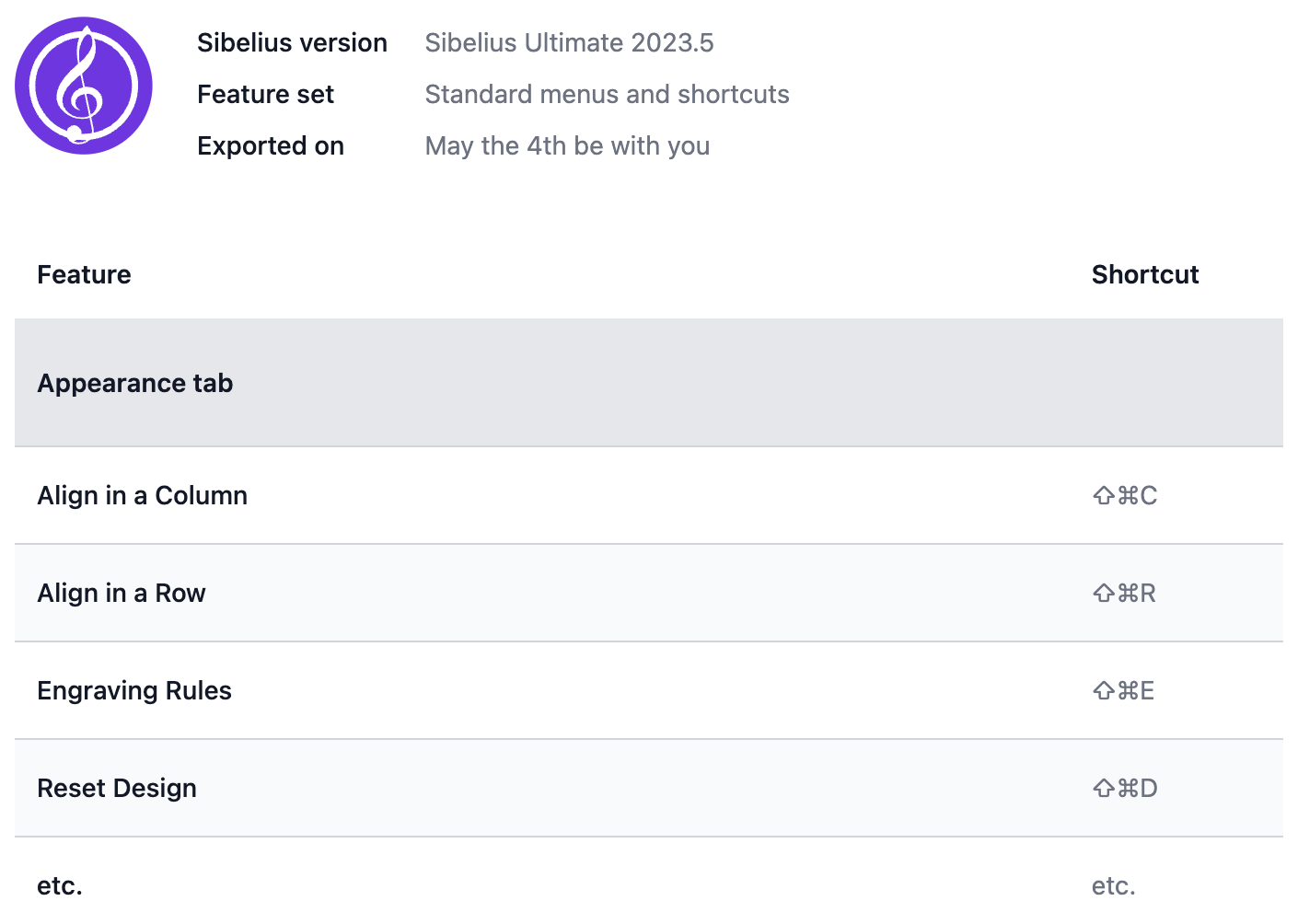

In this release, we’ve also added two long-awaited features to the Keyboard Shortcuts page in Preferences (found in File > Preferences). You can now search for a feature using the new “Search feature…” field:
8 Search shortcuts
Simply type some or all of the feature name you’re looking for and click Search. You can also now export your shortcuts in a simple HTML file. There are various options that will export your shortcuts with different grouping and order. The exported file is a single HTML file, which makes it really handy to print out or open on your phone or tablet.
9 Export Shortcuts
And it looks like this in your browser:
10 Shortcut list
