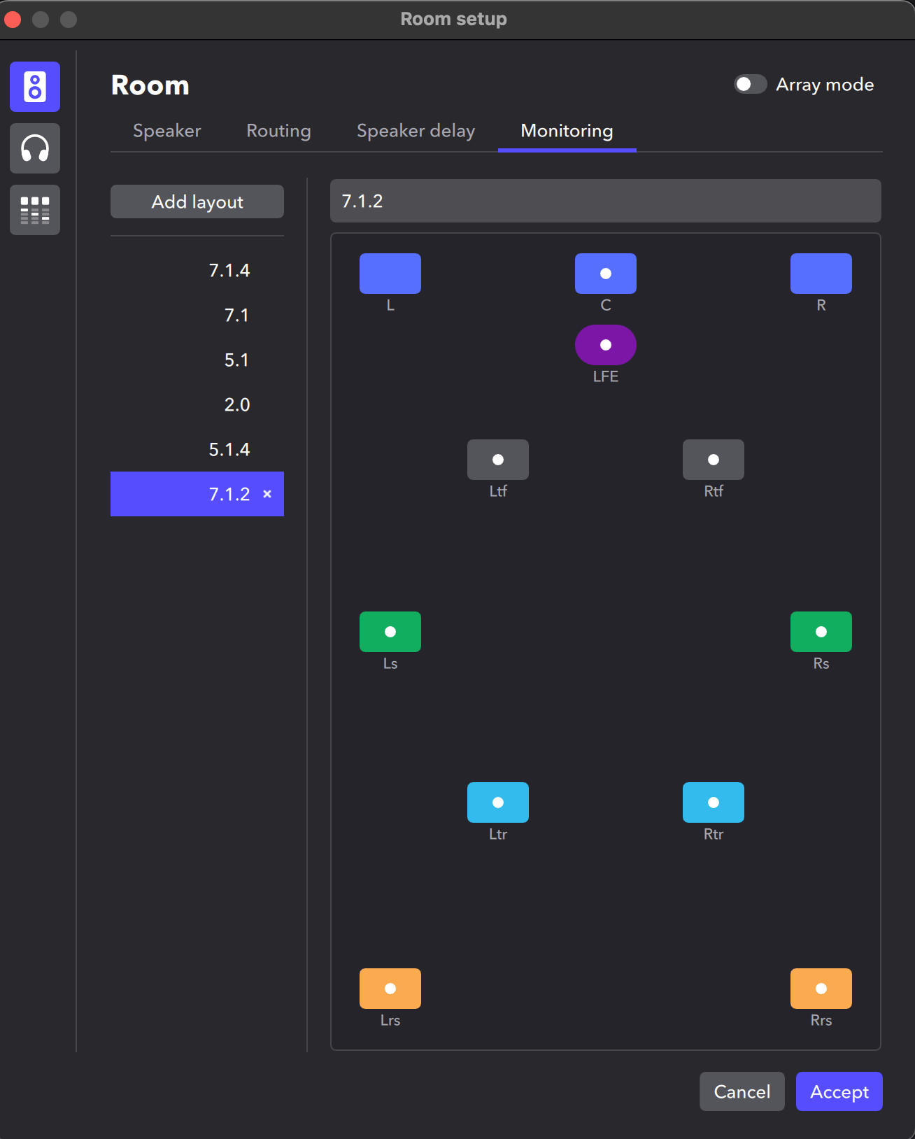

You will need to configure the Dolby Atmos Renderer to support a 5.1.4 or 7.1.2 format as they are not default room formats. In the Dolby Atmos Renderer, go to Setup, then Room Setup, select the Monitoring tab, and add your room’s format—5.1.4 or 7.1.2.

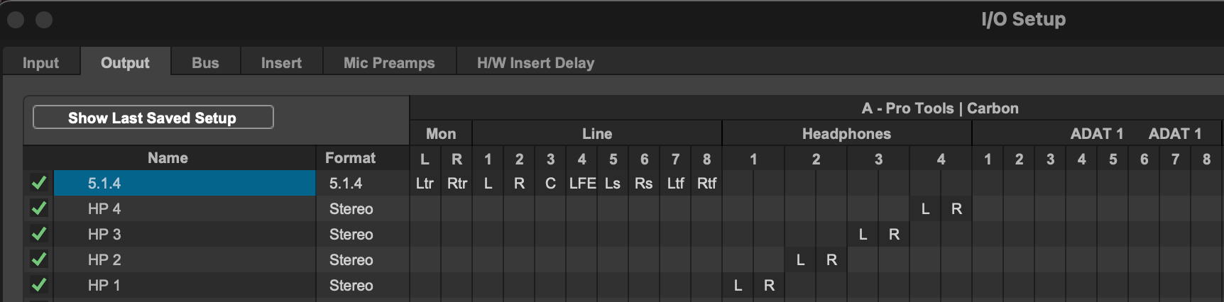

The I/O setups for 5.1.4 or 7.1.2 SMPTE channel outputs would be set as the image below.
IO Setup 514
IO Setup 712
