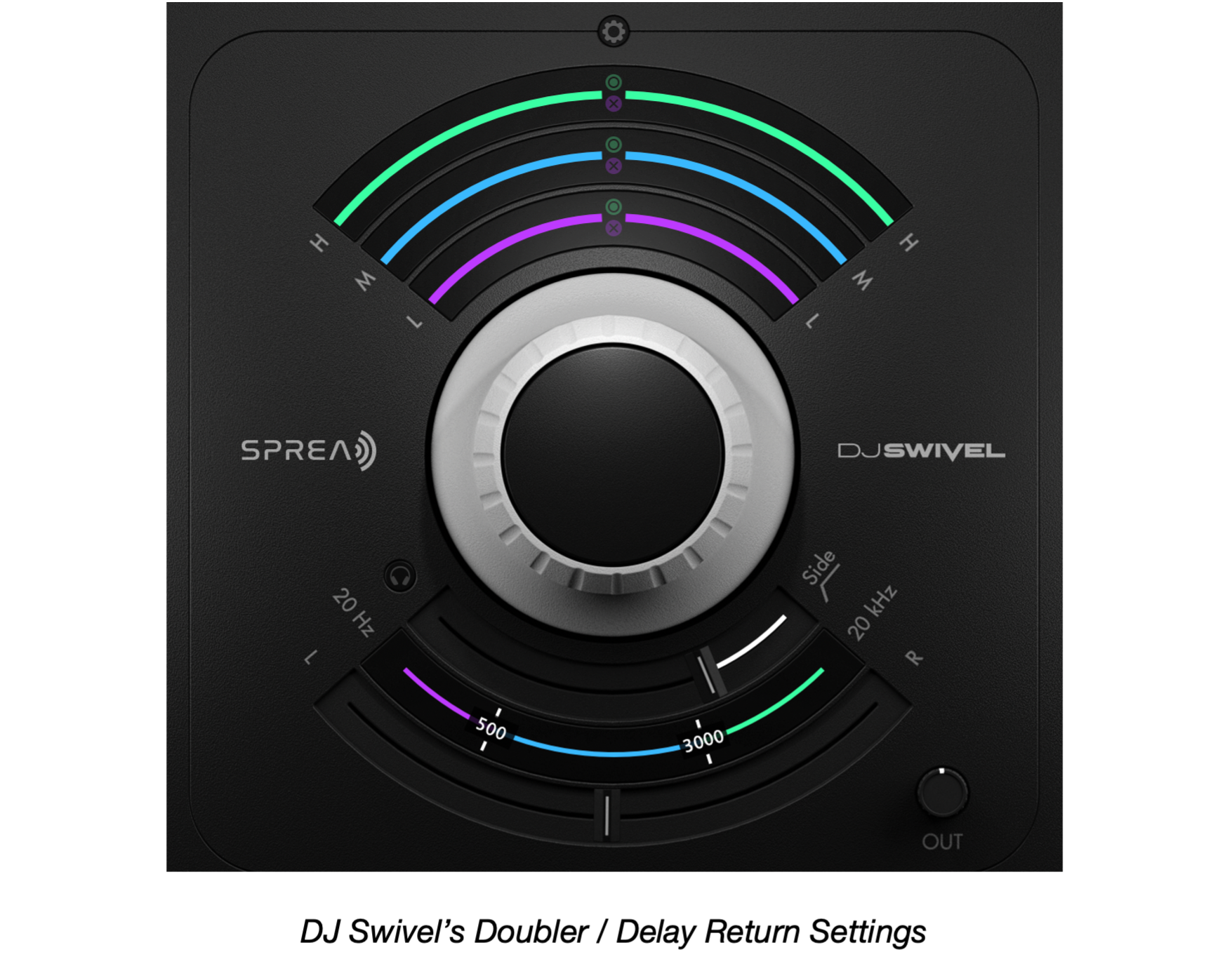

1. Instrument Width
This one is a simple one. When you're mixing a song and you have two guitars, you might pan one left and one right to create a nice wide guitar image. This is great if you have an instrument that's already stereo. But what if you have only one guitar layered with a number of other elements, and you're having difficulty creating space for it?
I often try to treat my mixes in a feng shui sort of way. Meaning, while the left and right channels don't need to be identical, they do need to feel balanced. Having an odd number of sounds in any given place in the mix can often feel cluttered and push too much of the weight of the mix to one side. Alternatively, if every sound in your mix is already stereo, sometimes you're just looking for creative ways to separate one synth from the next. Spread is my go-to tool for all of the above scenarios. Often, with multiple stereo tracks, I'll use Spread to make some tracks more narrow, others more wide, and others left alone, because this allows for a much larger feeling mix when you fill up more of the stereo image—leaving more room in the center for your drums and lead vocals.

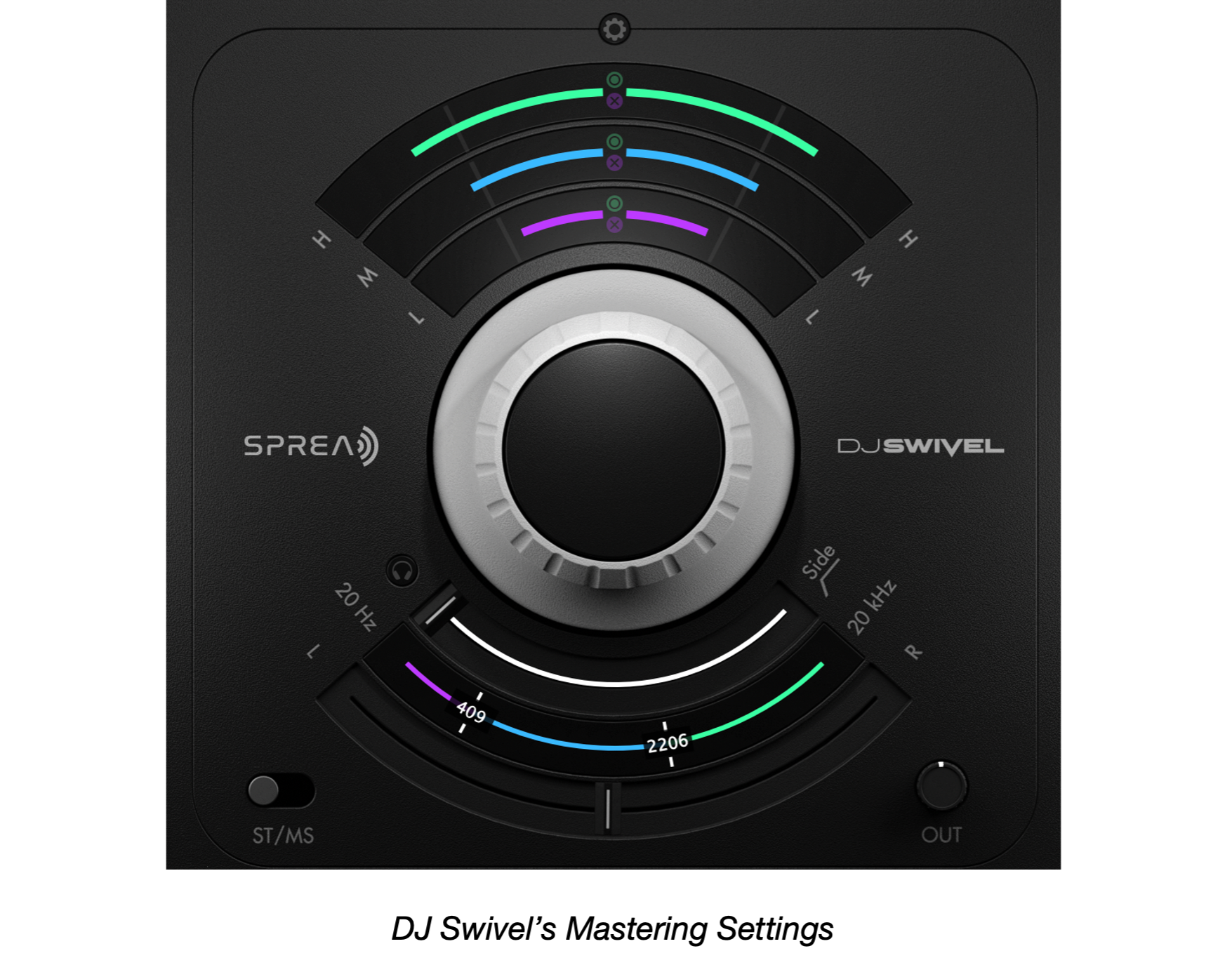

2. Doubling
I can't tell you how many times I've received background vocal harmonies that have each note sung only once. This often creates a balance issue that isn't aesthetically pleasing.
First, I love wide background vocals in stereo, and they should feel balanced. Sure, there's always the outlier scenarios where you may want one harmony panned left, and the other right, but generally speaking, I want the same frequencies shared between the left and right speaker. Often what I'll do here is throw an instance of Spread on the vocal harmony I'm looking to double, and push all frequencies as wide as they can go.
One of the great things about Spread is being able to take a mono signal and make it stereo. Spread doesn't add any irregular or weird phasing issues, which allows your vocal to fold down to mono with ease, without creating any signal cancellation. This is optimal for creating stereo versions of mono vocals and a frequent use case for me.

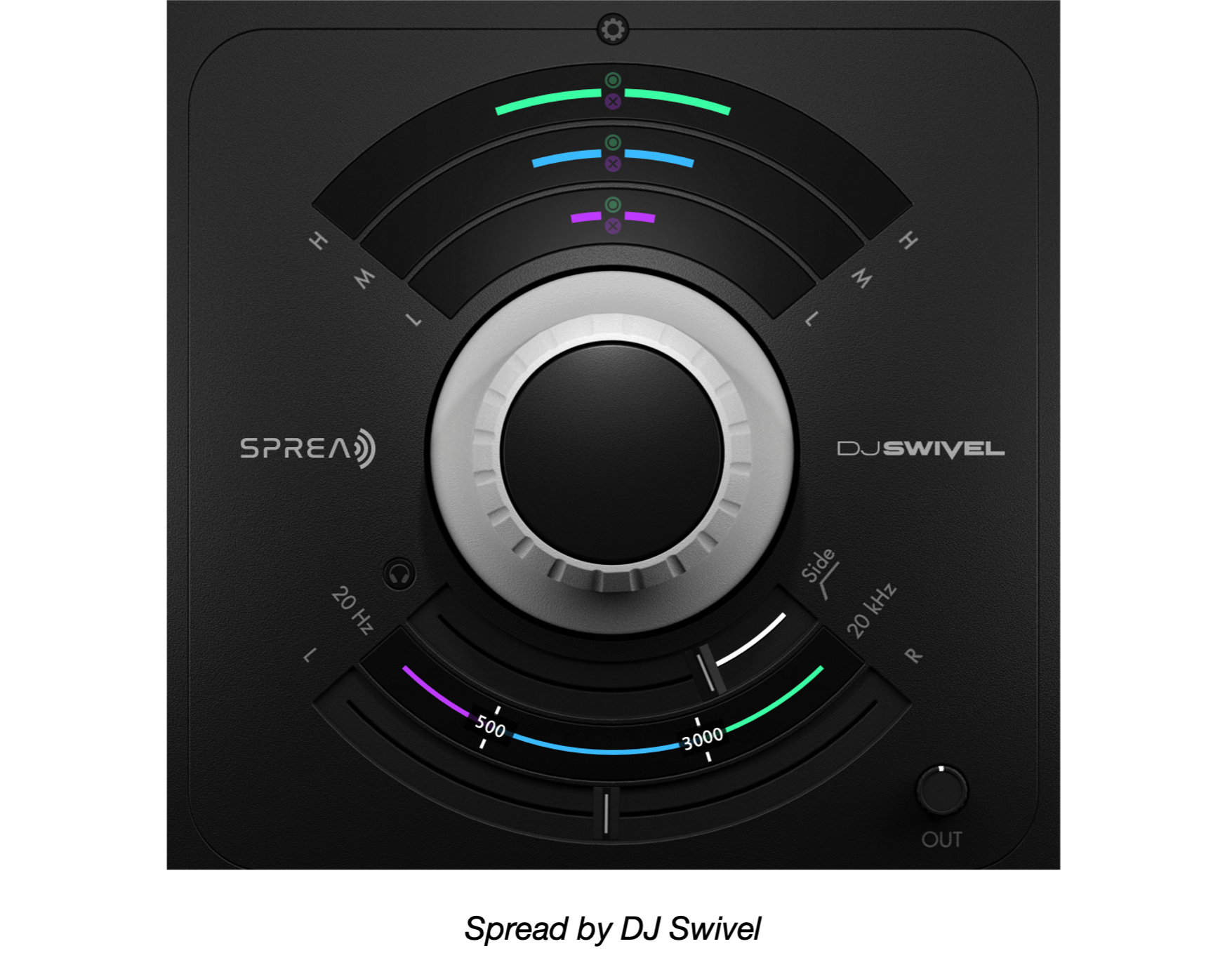

4. Mastering
So, you've finished your mix, and it's time to put those finishing touches on it before it's ready for the world to hear. You might start with some bus or multiband compression, a little overall EQ, and, of course, top it off with your limiter. But my secret weapon in every final mix or master I complete is subtle augmentation of the stereo image. Somewhere after the bus compression and before the limiter, I'll hit my master with an instance of Spread. When doing so, I generally stick to a simple recipe.
I like to fan-out the frequencies to create separation (and ultimately, size) in the mix. I usually start with the high frequencies (3kHz and above) by making them the widest. Then, I'll make the mids (500Hz-3kHz) a little less wide, and for everything below 500Hz, I'll often leave alone—or, in some cases, I'll even narrow the image. I do this because in addition to our balance and panning, our width (or image), needs to have its own definition, too. I want to be able to pick out each sound in a mix and give it clear space. By fanning out the frequencies on a master track, you give each frequency band its own individual space within the overall mix.
